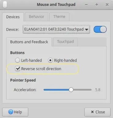

10
I searched a lot and also found a bugreport about it, but the solution was easy:
You have to select the Touchpad-device in the selectbox at the top of the mouse-settings.
(It was a bit hard, to find, because I didn't expect that the settings for mouse and touchpad are separately configureable.)

With Xfce 4.12 or above, you can go to Mouse settings and select Reverse scroll direction. The setting is under Mouse but it also reverses the scrolling direction for the touchpad.
