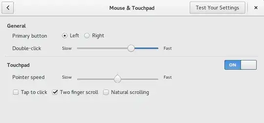

Below is the screenshot of my mouse&touchpad settings: enter image description here

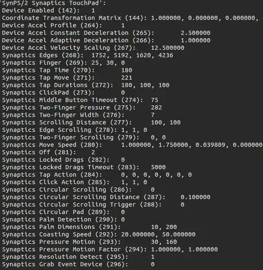

Results of xinput list-props 12 command:
Xinput list-props result

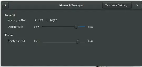

Have you updated the mouse settings? After updating I had the same issue, but it was just that tap to click had been disabled.
mouse and touchpad settings
Otherwise, according to this thread it could be worth logging out and back in.
