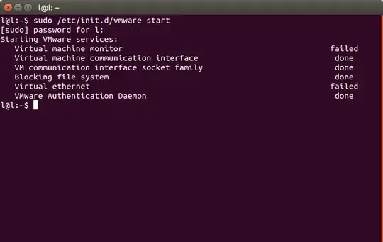

And I tried sudo /etc/init.d/vmware start command and I got this:
What's the problem?

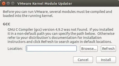

Try running
sudo apt-get install build-essential linux-headers-generic
then open your vmware & in 1st window and click Install, wait for about 7 mins & vmware will be open.

For kernel 3.x version - install the package gcc-4.9
sudo apt-get install --reinstall gcc-4.9
For kernel 4.x version - install the package gcc-5
sudo apt-get install --reinstall gcc-5
To always have the latest version installed

None of the other solutions here worked for me using Ubuntu 15.10 and vmware 12.1 pro, which was asking for gcc 4.9.2
The problem was caused by ld path (dynamic libs), and I needed to fix vmware as follows:
