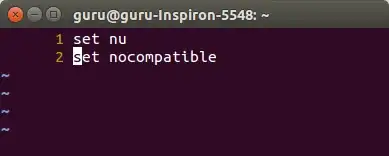

This is what my vi editor looks after I set the set nu option in .vimrc file in my home directory: vi editor screen-shot
As clearly seen, some amount of whitespace is being created to the left of line numbers. How can I remove this space so that I can better make use of my workspace.

That is, the default width is 4, but 8 when in compatible mode. vi in default Ubuntu is vim.tiny, which doesn't support nocompatible, so the width became 8. You need to install vim to get the normal behaviour.
That said, if you do wish to set a different minimum width, say 2, just do:
set nuw=2
