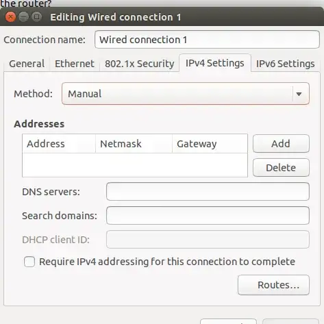

if you are using Ubuntu server then you can use @kyodake answer or other but if you are using Ubuntu Desktop environment then you can
System setting -->  Network --> Wired --> options --> IP4 settings
pic
you can take help from here
