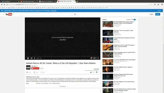

So I get the error "An error occurred. Please try again later." to the new interface as you can see in the photos.
What can I do?

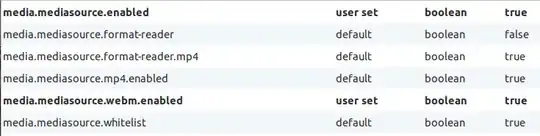

What solved this for me is setting media.mediasource.webm.enabled to true in about:config

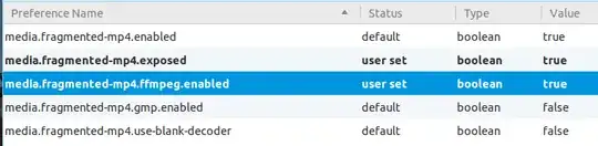

These settings let you adjust the video quality as well (to me it does not work out of the box, everything is only available on 360p). Here is the full config I have, for reference:
Settings for media.fragmented*: Settings for media.fragmented*
Settings for media.mediasource*: Settings for media.mediasource*

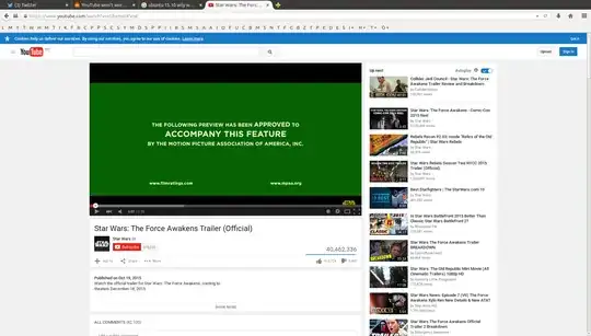

I think I was able to reproduce this issue and up until now I didn't modify any settings in about:config as Zoltan mentions while HTML5 versions of YouTube and Vimeo have both been working fine for me. I just installed gstreamer1.0-libav which got me this far on YouTube's HTML5 page:

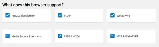

I've run into this problem as well. The youtube html5 gives me a blue checkmark on all options. If you play a video, then it works. However, if you disable webm, then it fails like in the top post.
Looking into it further, you find that it fails to play every video of type "video/mp4", which basically means that the h264 decoder is recognised (as shown by youtube) but not working.
