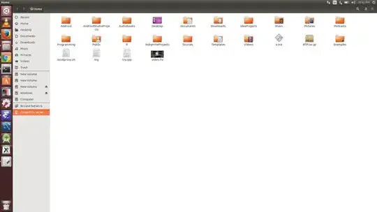

Notice the Connect to server in the left panel, that's what i am talking about.
