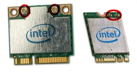

  • unplugging the antennas cables from the card, and re-plugging in a changed order
