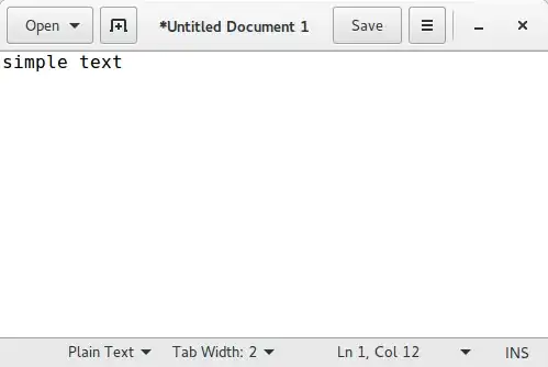

Open your file in gedit and click on Plain Text as you can see in the next screen shot:
Predefined syntax highlighter can you find in
/usr/share/gtksourceview-3.0/
Answer for the first version of the question
A simple text (Plain Text) file hasn't a syntax highlighting in gedit

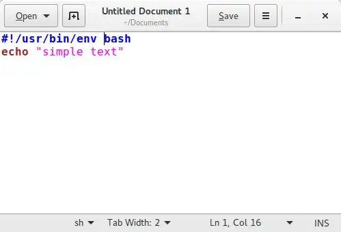

Add some code in the file and save. Now the syntax highlighting for bash (sh) is active. You can see this in the status bar in the screen shot below

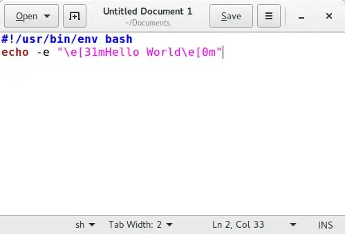

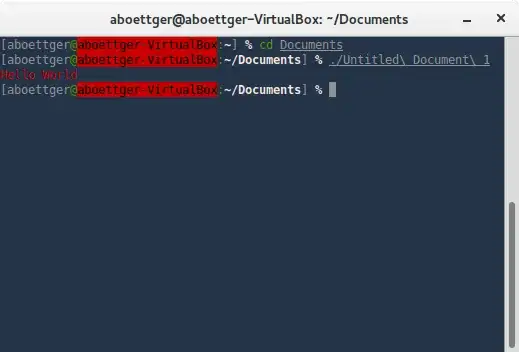

The colours of a shell script in a terminal is possible with escape sequences, see the next screen shots
As you can see, those are completely different things. In gedit you have colours via syntax highlighting and in a terminal with escape sequences.
