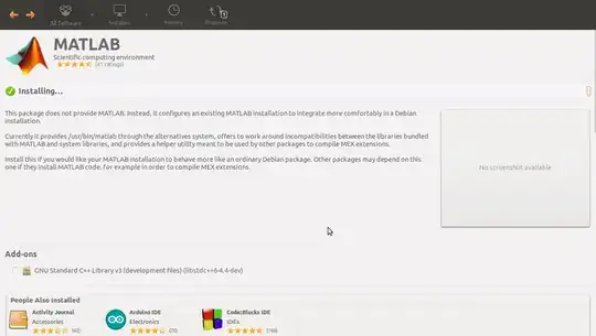

I am trying to terminate a software installation from Ubuntu Software Center. I tried installing matlab-support 0.0.17 from the software center:
This package does not provide MATLAB. Instead, it configures an existing MATLAB installation to integrate more comfortably in Debian installation.
However, I didn't have MATLAB installed on my system and accidentally attempted to download matlab-support 0.0.17. As a result, I'm facing the following problem:
Whenever I open Ubuntu Software Center, I notice that there is a process always running. It shows matlab-support 0.0.17 installing...

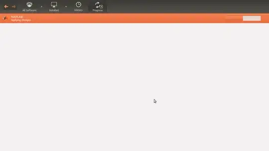

I look for a way to terminate the installation from the Progress tab to get this:
Once there, I see no way to deselect or terminate the process.
