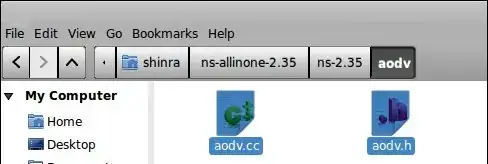

A protocol has been created with 2 main files(there is some protocols with only one file too but i'm talking about the most of them) in ns2 that one of them has .cc type that contains the protocol's name(like AODV.cc) for definition and the other one has the .h type for declaration and it also contains the protocols name(like AODV.h).
There could be other files including the protocol but the main is protocolname.cc.
