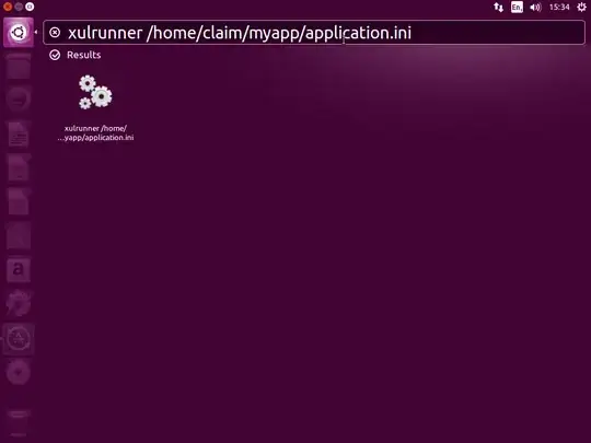

You have a couple of options.
You could either run from the graphical "Run Command" - the equivalent of Windows + R. You can also find this in the start menu on Windows.
On Ubuntu, you use Alt + F2 to open this:
And on lubuntu it is "Menu" -> "Run".
And then run the command
xulrunner /home/clain/myapp/application.ini
graphically, without a terminal being needed.

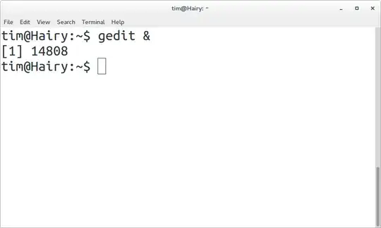

Your second option is to run in a terminal, but unlink it from the terminal with the & character, like so:
xulrunner /home/clain/myapp/application.ini &
this will start it as a separate process. Here is an example with Gedit:

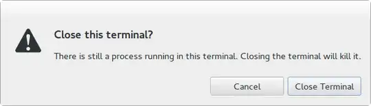

As you can see, I can run another command without affecting Gedit. It will keep running. If I was to not use the & the terminal would be attached. Closing the terminal gives this message:
And of course if I do close it Gedit will stop. If I use the &, there is no active process so the terminal can just be closed.
