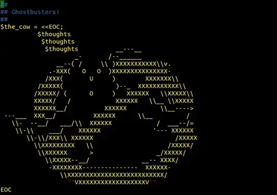

Which all seem to be different cool things like this was the contents of ghostbusters.cow:

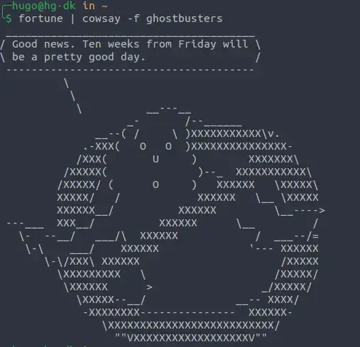

To achieve what you want run :
fortune | cowsay -f ghostbusters
And for random ... :
fortune | cowsay -f `ls /usr/share/cowsay/cows/ | shuf -n 1`
