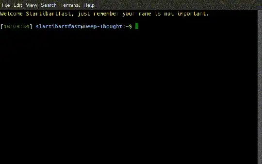

I have recently noticed something odd that I don't like very much:
When running ls I get a train
So why am I getting a train upon running ls? And how can I stop this and make it behave normally? Is this an Easter Egg that I have discovered? I am running Ubuntu GNOME 15.04.
Information Update:
Running which ls gets me the same train, and running ls -l $(which ls) just gets me another type of train.
Running command -v ls outputs nothing. And running command -v sl also outputs nothing.
This may all have something to do with the cow (or something like that) package that I recently installed that promised to 'lighten things up a little'.
