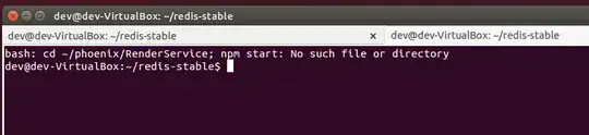

The second chunk is where I'm running into problems. Apparently cd doesn't work in shell scripts, but that particular link is way over my head, and I don't understand how to implement any of the solutions shown there. The specific error I get is:
bash: cd ~/phoenix/RenderService; npm start: No such file or directory
The tabs that open via the loop have prompts in the redis-stable directory:

  options+=($tab --title="${titles[i]}"  -e "bash -c \"${cmds[i]} ; exec bash\"" )
done
gnome-terminal "${options[@]}"
