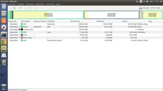

partitions

You can check the partitions with GParted - the tool is included in Ubuntu installation media.
