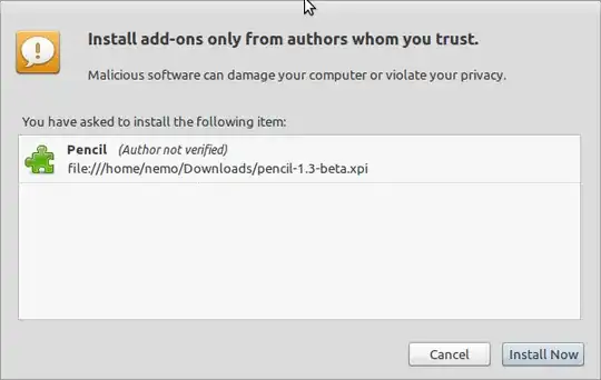

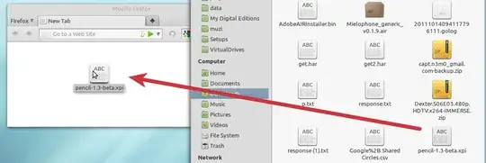

You can install the xpi file as a Firefox addon. To do this, drag the xpi file from your documents to Firefox. It should show a popup asking you about installing the package.
drag and drop into firefox installation screen

Alternatively, if you haven't downloaded it yet, you can go to Tools -> Addons or about:addons in Firefox and search from as well as install from there.
