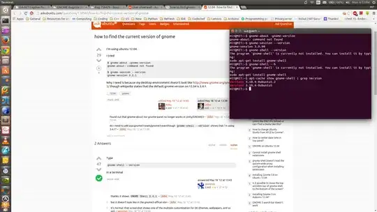

I want to know if I have gnome installed or not. So , I have consulted this question: how to find the current version of gnome and How do I check my version of GNOME-Shell? . But I got different answers as mentioned in screenshot.
I am confused. So , can anyone describe me this situation?
Thank you in advance! enter image description here

I do not see an issue: you do NOT have gnome-shell installed so any command asking for a version of gnome-shell, or any command related to gnome-shell, will error out. And you have Unity installed and that would be the case when you installed a default Ubuntu
unity --version
will show you the version of that.
