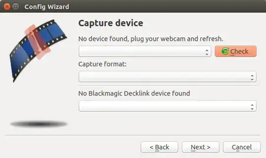

I am having difficulty getting a system to cooperate with a video camera using kdenlive and an IEEE1394 connection.
From running lshw, we can see there is a card for such connections recognized:

The installed system is Ubuntu 15.04. The camera is a SONY HVR-HD1000U.
Screenshot from kdenlive when the camera is hooked up to the computer and working in playback mode:
Screenshot showing kdenlive cannot see the camera
The kdenlive developers have a troubleshooting guide for this.
https://kdenlive.org/user-manual/troubleshooting-and-common-problems/troubleshooting-firewire-capture
In my experience this has usually been a permissions problem rather than a driver or kernel module one. The guide does mention creating udev scripts but those are well documented.

The above link to the troubleshooting guide is outdated. Use the following link instead:
https://old.kdenlive.org/user-manual/troubleshooting-and-common-problems/troubleshooting-firewire-capture
But it seems that the firewire/IEEE 1394 capture feature is no longer maintained:
https://bugs.kde.org/show_bug.cgi?id=355967
