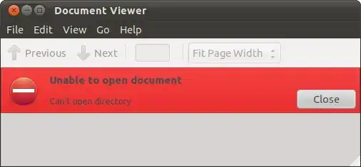

When I try to open a file that has been downloaded from Chrome, or any folder in the menu bar "Places", evince opens with an error.
The error does not occur when I open a file with a particular program from the command line (ie: gnumeric myfile.xls) or if I open and navigate from Places>Computer, although it does occur with Places>Home Folder, Places>Desktop, etc.
For example, this is the result of clicking on Places>Desktop:

  • removing evince: received 'Failed to execute default File Manager'...
Need to change your default file manager. Either follow the steps at help.ubuntu.com, or simply type
 exo-preferred-applications
at the command line, select the 'utilities tab' and switch to your favorite file manager (e.g. Nautilus, Thunar).

Try uninstalling evince
sudo apt-get remove evince
With evince no longer on the machine, check what response chrome gives to opening files, and it might point you in the right direction.
