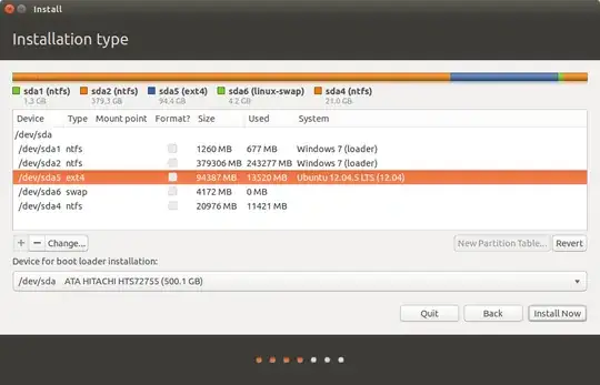

I definitely don't want two versions of ubuntu, and I want to keep my windows 7, so I have to choose "something else". And here's where I am unsure about. It asks me to choose a device for boot loader installation. Apart from windows system related disk space, I have two partitions under /dev/sda:
  • /dev/sda5 ext4 (Ubuntu 12.04.5)
  • /dev/sda6 swap
Installation Type
My Ubuntu 12.04 is installed in the partition /sda5, but I don't know what /sda6 is used for. It has around 4GB space and 0MB is used.

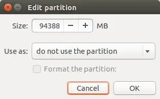

If I double click the format little square button, this window will pop up:
Edit Partition
It looks like I can also choose to change the size but I suspect that it wouldn't be safe to do here.

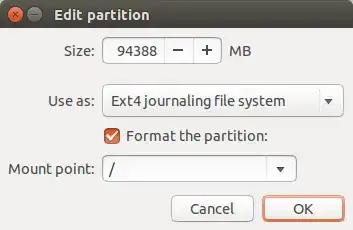

I am changing the settings of my /sda5 in this way:
Ext4

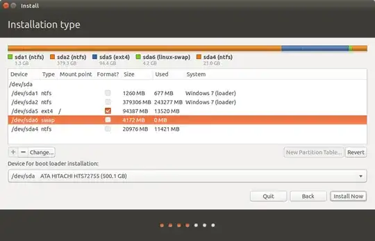

And /sda6 is automatically chosen as swap area. All other ntfs partitions are left as do not use the partition. Boot loader should be installed at the beginning of the drive in which your ubuntu is going to be installed. (In my case, it's /dev/sda/.) So my final settings are like this:
Final
Click install now, and it Worked!!! Thanks everyone!

  1. Choose "something else".
  2. Select your sda5 as your / partition (mount point) and click to format it.
  3. Select sda6 partition to be used as swap.
That will install Ubuntu the same way it was installed before.
