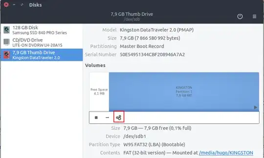

You can use Ubuntu Disks utility. Open the Dash and search for Disks.
Select your USB key in the menu on the left, click the gears and select Edit Mount options :
From here simply check : Mount at startup :
