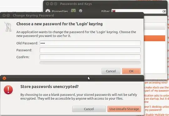

  • In the Password application, right-click the Passwords: default
  • Select Change password
  • Enter the old password, and no new password then click OK
  • Confirm to use unencrypted passwords:

Open seahorse and go to View -> By Keyring. Now right click the login password and choose change. Enter your password when asked for the first time but leave the new password blank. It'll ask for a confirmation and after that you should be good to go.
