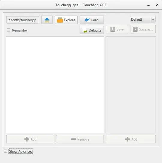

please, help me! how to install Touchegg-GCE in Ubuntu?
15
First install dependencies:
sudo apt-get install build-essential libqt4-dev libx11-6 libx11-dev
Download the .zip file from here
cd ~/Downloads
unzip Touchegg-gce-master.zip
cd Touchegg-gce-master
qmake
make && sudo make install
To launch touchegg-gce you have to go to that particular folder.
The binary is installed in /usr/local/bin, check your PATH. Or start via your Application Launcher, there is a desktop file in /usr/local/share/applications/touchegg-gce.desktop
