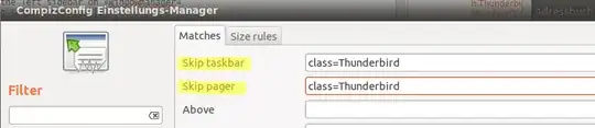

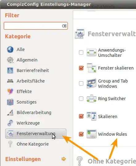

There is a very simple solution for that: You can configure Compiz to skip the taskbar and the pager for specified Applications. To do so with Thunderbird you have to perform following steps:
  1. Go to Softwarecenter and install CompizConfig or use following command:
    sudo apt-get install compizconfig-settings-manager
  2. Open CompizConfig-Setting-manager using the Dash or performing this command:
    ccsm
  3. Click on the left sidebar on »Windowmanager« CompizConfig-Setting-Manager
  4. Now you can specify windows you don't like appearing in taskbar and the pager: For Thunderbird you type in the filed »Skip Taskbar« and »Skip Pager« the following:
    class=Thunderbird Typing the same in the filed »not closable« you should have exactly the behaviour you want.
Skip pager and taskbar for Thunderbird
