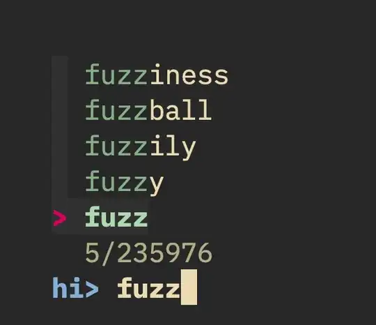

None of these answers gave me the 'type some random stuff and it just works' feel I was looking for so I used a different approach that I think works much better using fzf (sudo apt install fzf)
Let's take a simple case first.
Let's say we want to echo some word from a dictionary (/usr/share/dict/words) with auto-suggestions of the words.
We can do this with this bash function:
 function ppp(){ echo "Your word is: $(cat /usr/share/dict/words | fzf -q "$1" --prompt "hi> ")";};
Paste that into your shell then try:
ppp fuzz [hit enter]
Choose your word by typing more letters or using arrow keys, hit enter, and:
Your word is: fuzzball
Perfect.

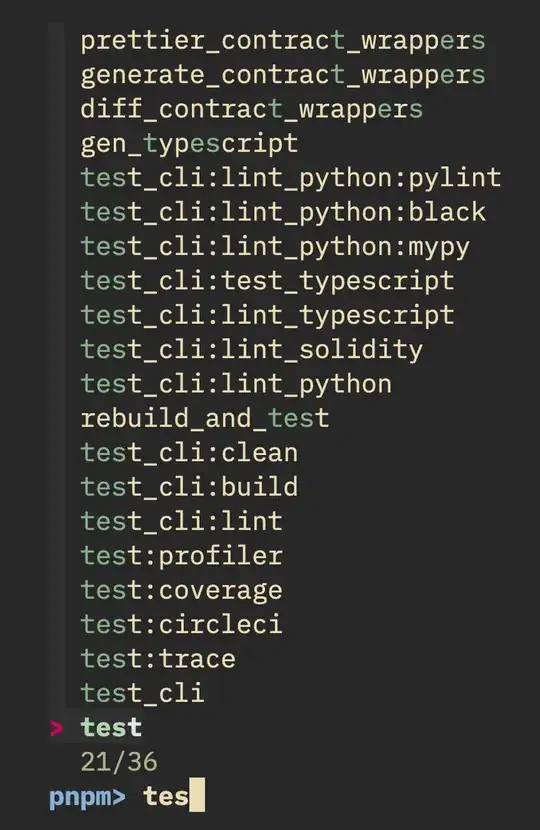

Now let's take a more interesting example - let's do auto-completion for a package.json file's "script" commands
First sudo apt get install jq fzf then copy/paste this function:
function ppp(){ pnpm $(jq -r ".scripts|keys[]"<$(pnpm root|sed 's/node_modules//')package.json|fzf -q "$1" --prompt "pnpm> ");};
Now go into a node project folder (or subfolder) and
ppp tes
This works for anything for the pattern of filter/choose/run command.
Add the function to your .bashrc and happy days.
