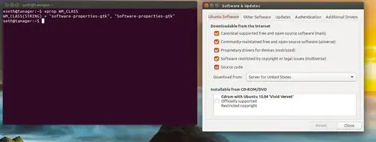

It's not perfect, but the WM_CLASS property usually holds the package name and/or binary name. You can retrieve an application's WM_CLASS property with the xprop command:
xprop WM_CLASS
Your mouse cursor will turn to crosshairs. Click on the program. xprop will return the property.
So far I haven't found an application where this doesn't work, but it is possible some won't have the information you want held in the WM_CLASS property.
