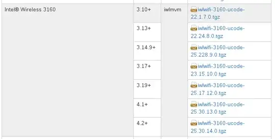

Anyway, the driver you are referring to is the iwlwifi driver - e.g. by looking at the page or following these links: Intel Wireless AC 3160 card > Driver Downloads > Linux driver (3/25/2014). This has been included in the Linux kernel for ages - also if your card is the same as the 'IntelĀ® Wireless 3160', that it has been supported since kernel 3.10:
iwlwifi support table screenshot
So if you are yet to install Ubuntu, you should be able run Ubuntu on your machine with wifi working 'out of the box' (you can also check if it works from the live installer disc, without installing). Linux systems are generally not like Windows where you have to download weird software of websites to get it to work - everything you need (apart from some weird third party, often Windows/Mac only software) is included in the distributions repositories in packages, and can be installed from a Package Manager (e.g. the apt-get or aptitude command, sort of Software Center and Additional Drivers, Synaptic etc).
