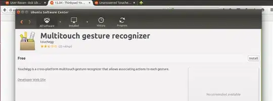

You can also install from Software Centre:
Imgur

This can also be installed from the Ubuntu Software Center
Install via the software center
