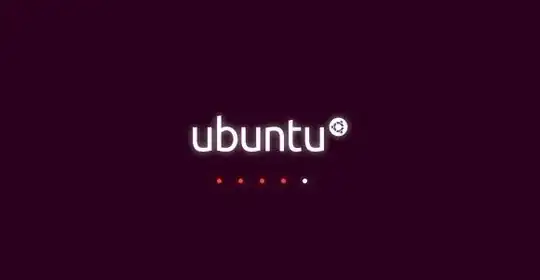

I am using ubuntu 14.04 64 bit. The problem I am facing is, I can not shutdown my machine. Every time I shutdown or reboot the computer (both from terminal and GUI) it get stuck at boot splash screen and stays there forever until I shut it down by pressing the power button..
stuck at shutdown
I have gone through the question- How to troubleshoot slow shutdown and it's answer but could not diagnosis the problem. There are some log in /var/crash/ but could not find any string Title: MISBEHAVING_PROGRAMNAME in them. My kernel version: 3.16.0-50-generic I have booted with previous kernels form grub menu but the problem persists. How do I solve the issue or at least find out the reason behind it?
