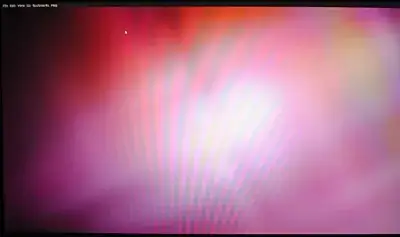

The only option then is to click OK, this dumps me out to full-screen Nautilus, like this: desktop
There is no launcher or visible way to start any programs. Print screen doesn't take a screengrab. The desktop is similar to this question but I get no terminal when I press CTRL+ALT+T. I have to press CTRL+ALT+F2 and restart from the terminal to get out of this. This answer is to install gnome-system-tools. Shouldn't I be able to add a second user with the default install?
