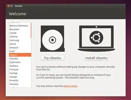

I use a HP Pavilion dv6 laptop that runs on Windows 7. I'm unable to install Ubuntu 14.4.3 into the PC. I have created a flash drive (thumb drive) with Ubuntu on it using the tool in pendrivelinux.com/ First of all, I don't see the welcome screen that should look like this at all:
I see a black and white screen with the logo of Ubuntu and a bunch of options one below the other and I have no idea why. I can try Ubuntu using the flash drive. When I attempt to install it, it simply doesn't let me.
