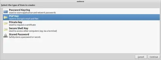

  1. Open the Passwords and Keys app (aka seahorse), and click + (or go to File->New, or press CtrlN) to see:
    new item dialog for Seahorse

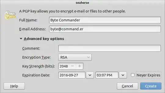

  2. Select PGP key, and enter your details. I'm impersonating Byte Commander:
    key details dialog
    RSA and 2048 bits are fine for most purposes. If you only want to use it for signing, pick the RSA (sign only) option from the drop-down menu, but you shouldn't need to - this can be handled using subkeys. You can leave a comment. Keeping an expiry date on your key is also useful. Click Create.

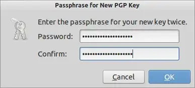

  3. Enter a suitably long password (and I mean long, my example is short, IMO), and click Ok:
    password entry dialog
    Seahorse doesn't seem to have any feedback, unlike the CLI. Wait around for a while, doing whatever you want to do, while it gathers entropy and creates a key. It might take a while. After which, you'll see they key in the PGP Keys section:

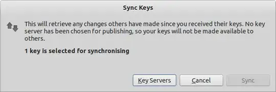

Head back to the list of PGP keys in the seahorse app (see last screenshot). Select the key(s) you want to export, and in the Remote menu, pick Sync and Publish Keys:
The Sync button will be disabled if you haven't selected a server to publish to. Do so, by clicking on the Key Servers button:
I picked Ubuntu's server.
Now, you can click the Sync button and have it published to Ubuntu's keyserver (sorry for the spam, Ubuntu!).

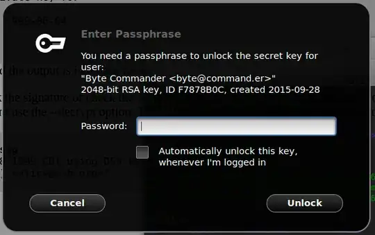

If you're on a desktop session, chances are you'll be greeted with a graphical password prompt. For example, in GNOME:
