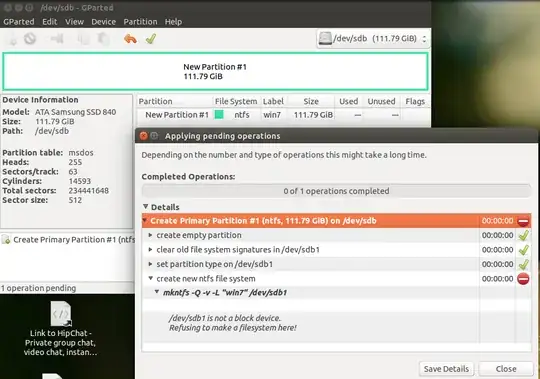

I'm trying to use GParted on Ubuntu Desktop 14.04 LTS to clone a partition from one device to a newer device (three devices are in play total if you include the one I'm working from). I'm fine using the terminal but haven't gotten the commands correct. The newer device has more space than this one partition I'm going to clone over, and I created an msdos partition table, so all I need to do is create a new partition as ntfs.
The Issue
GParted (the version in the repo: 0.18.0) isn't recognizing the ssd as a block device. not a block device
I attempted sudo mkntfs -Q -v -L -F "win7" /dev/sdb1 which is what uis said plus -F for force, but it spit back Cannot understand the number of sectors '/dev/sdb1'. I'm not very comfortable doing disk partitioning commands in the CLI without expert help, and I wasn't sure forcing it was right anyway.

Solution
The accepted answer below was my solution: I formatted as EXT4. It fixed something the NTFS driver was failing to fix, so when I deleted the EXT4 partition, I was able to format as NTFS.

The error is weird. Of course it is a block device. Maybe just a little hiccup.
It always sounds like a joke, but seriously; Did you try turning it off and on again?
Check the output of ls -l /dev/sdb?. It should begin with a b for block device.
I can tell you though, why the command line invocation fails.
The correct syntax of mkntfs (from the man page) is:
mkntfs [options] device [number-of-sectors]
Compare with your invocation
which gives /dev/sdb1 as number-of-sectors.
The order of parameters matters!
Since I guess win7 ought to be the partition label, you need to turn around -L -F
mkntfs -Q -v -F -L "win7" /dev/sdb1
Although I'm not sure about forcing it, if there's problem with the device file.
