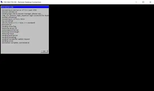

I'm trying to connect from my Windows 10 PC to my Odroid XU4 and after the connections is successfully established (at least I assume so), the screen on my windows pc turns grey for a couple of seconds and then it disappears without any error message. I installed ´xrdp´ on my linux machine. Following are the 3 steps:
Insert Credentials: enter image description here
Connection builds up: enter image description here

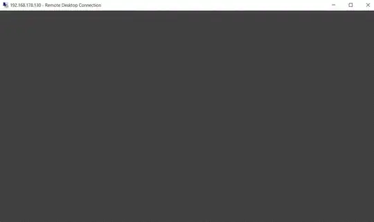

Blank screen, shortly before silent abort: enter image description here
##Abort##
