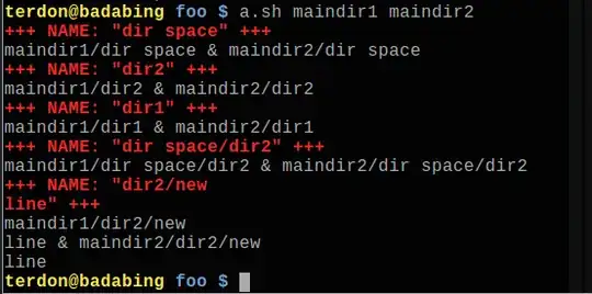

It will return this:
Screenshot showing the script's output
