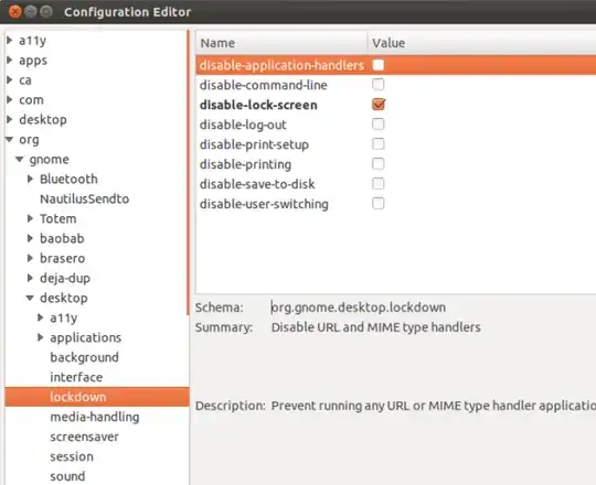

I did the following in terminal and it worked for me:
sudo apt-get update; sudo apt-get install dconf-tools
dconf-tools
( the equivalent terminal command is:
 gsettings set org.gnome.desktop.lockdown disable-lock-screen 'true'
Here's a picture of mine:

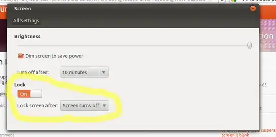

You can do it in system settings -> screen
change the lock toggle to off
