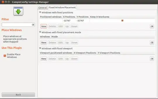

I'm not sure if it can do what you are asking but compizconfig-settings-manager Install compizconfig-settings-manager can do many tricks and you might find an answer there.
By choosing Place Windows in Windows Management you are able to individually define a fixed location for windows:
