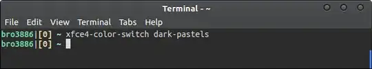

Copy this to somewhere in your PATH (for example, ~/bin/xfce-color-switch). Then:

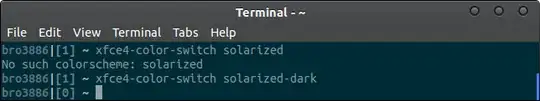

$ xfce4-color-switch dark-pastels
$ xfce4-color-switch solarized
No such colorscheme: solarized
$ xfce4-color-switch solarized-dark
You'll have to remember colorscheme names for this, but I'll add instructions on how to add tab-completion once I figure them out.
