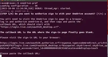

Step 3: After installation you will see message like this:
onedrive-d installed successfully.
Please run command `onedrive-pref` to set up the program.
Now open terminal and run: onedrive-pref
Imgur
Open the link in browser and enter your user id and password.
you will see prompt like this :
Imgur
Click on YES. Then copy the link and paste it in terminal.You will see message like this:
onedrive-d has been successfully authorized
Next,you need to adjust settings,if you want to keep default settings just press n .If you want to change press y and adjust.
