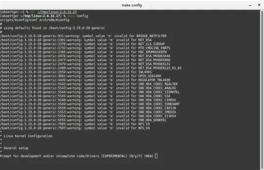

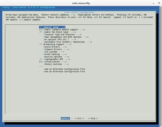

The only reason you need qt3 is because you ran make xconfig. There are other ways of configuring your kernel for compilation that don't require qt3. When I was young, I did it this way:
make menuconfig
Or, really old-shool:
make config
