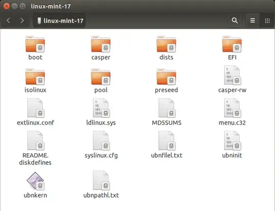

I have a strong suspicion that this has to do with file permissions. In Nautilus all files and folders appear to be locked, see screenshot. Gparted also shows a key symbol. (Boot flag is set.)
Nautilus screenshot

How can I make the Live USB boot again?
