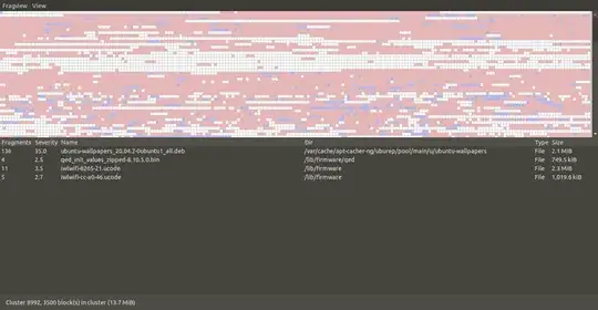

Fragview does what I needed and more.
Screenshot of Fragview
As you can see if I click on an area of the map it shows which files are in that area, and how fragmented they are.
I can now use btrfs filesystem defrag should I wish to do so.
Running on Ubuntu 18.04 amd64 with a BTRFS filesystem.
