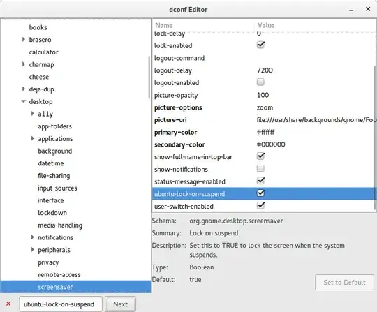

  • 92,125
Graphically, use dconf Editor to flip the status of org.gnome.desktop.screensaver ubuntu-lock-on-suspend from checked to un-checked
