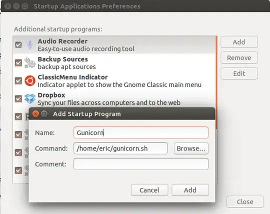

An easier way to do this do is just to add a new startup application. Search "Startup Applications" in the dashboard and point to your script. This way you can keep it anywhere you want.
example
