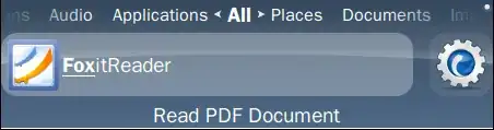

The progress bar do her job and an icon appears when I search for Foxit on launcher. It is also present in the menu, in Synaptic manager, and is seen by other launcher application like Synapse.
synapse, foxit

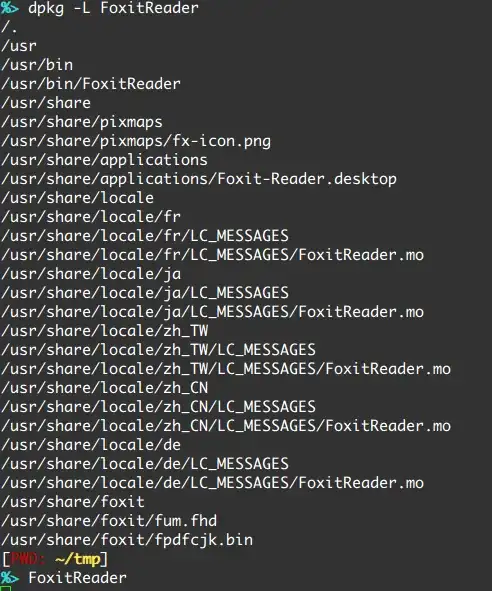

@update
See the pic below , did you try run FoxitReader (i picked 1.1 version from website)
