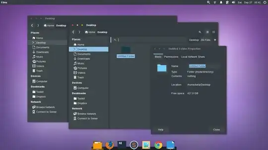

Does anyone know a polar night theme alternative without the bluish hightlight? I like the closing icons very much, but the blue is a killer for night work.
Link: http://www.noobslab.com/2014/08/polar-night-dark-gtk-theme-for-ubuntu.html
