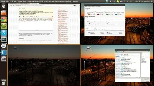

The way I understand the workspace spread, if you have an active window in a particular workspace, it is coloured in the workspace spread. Or, in case there are no active window, as you seem to have noted, they are dark and faded.
If you select a workspace, the workspace will have an orange outline to indicate that you have selected the workspace. You can refer to the image for clarification. You can select the unused workspace in the workspace spread without any problem.
If this answer is unsatisfactory, you can try resetting Unity to its defaults and see if that helps your problem.
