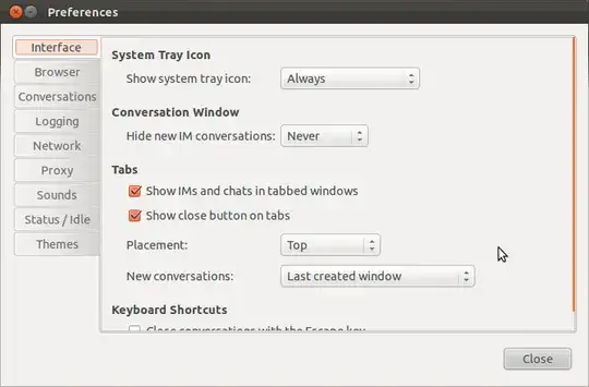

For 12.10 and older:
execute:
gsettings set com.canonical.Unity.Panel systray-whitelist "['all']"
(from http://www.webupd8.org/2011/10/things-to-tweak-after-installing-ubuntu.html)
and remember to set the system tray to "always" in pidgin preferences.
If the change doesn't take effect immediately, run unity --replace
