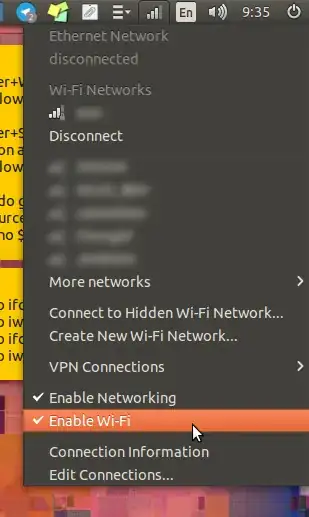

  2. Try to enable the wireless from network panel
